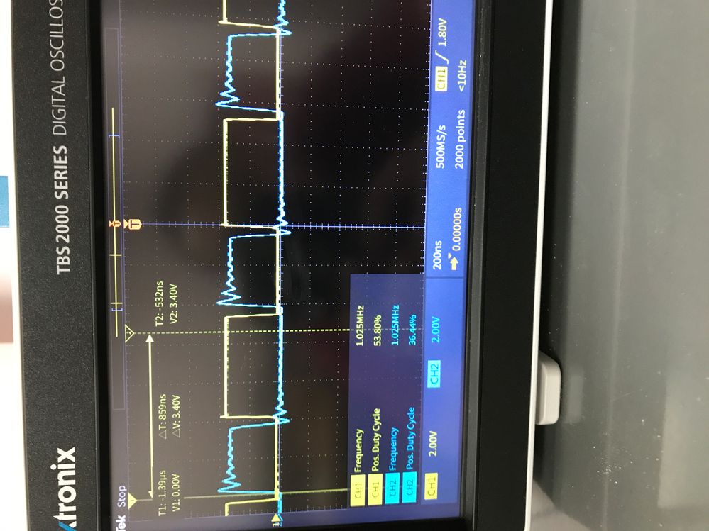

2020-07-07 6:07 AM
Thank you all for your responses...
I've the screenshot of the signals attached from the scope. As it can be seen, the signals are skewed due to the slew rate and high PWM frequency.
With the parameters as below, I am able to generate 1 MHz PWM signals with some dead period insertion. Again, I don't think the shape / skewed signals would be of any problem in the application. My main concern is limited resolution available in PWM duty cycle variation with some dead period insertion.
I am still exploring the dead period (DTG) and Clock Division factors in CR1 registers to check all available configurations.

2020-07-08 1:09 PM
> (Maximum APB2 Clock available is only 90 MHz; and not 180 MHz with STM32F446RE).
Yes, but timer clock is twice the respective APB clock, if APB divider is >1.
Slew rate of signal edges is given by GPIO_OSPEEDR setting.
2020-07-08 2:36 PM
To reduce ringing probably try to enable the compensation cell also. Read RM0390 section 8.1 and look for SYSCFG_CMPCR register.
