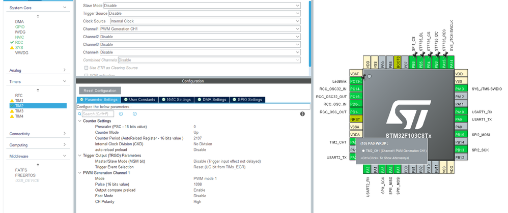

Best course of action would be to use a TIM clocking at 72 MHz and divided by 2197, that would be around 32.772 KHz

Is it right configuration?
