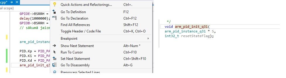

2018-01-03 5:43 AM
I think I am. When I click Go to Definition it opens arm_math.h and shows me this.
2018-01-03 5:58 AM
Ha - that's Keil being sloppy with their terminology!
That is just a function prototype - it is not a definition - it is just a declaration.
See: C-FAQ
http://c-faq.com/decl/decldef.html
So, as in the previously-linked forum thread, you need to also include the .c source file which provides the actual definition (ie, the implementation) of that function ...

2018-01-03 6:09 AM
Ok, thank you!
I searched for .c file and found that there is \STM32H7xxxx\CMSIS_HAL\DSP\Source\ControllerFunction\
arm_pid_init_q31.c
So I included it in my code and now I can build it.
I do not know much about this stuff, but I was wondering why it wasn't included in arm_math.h
