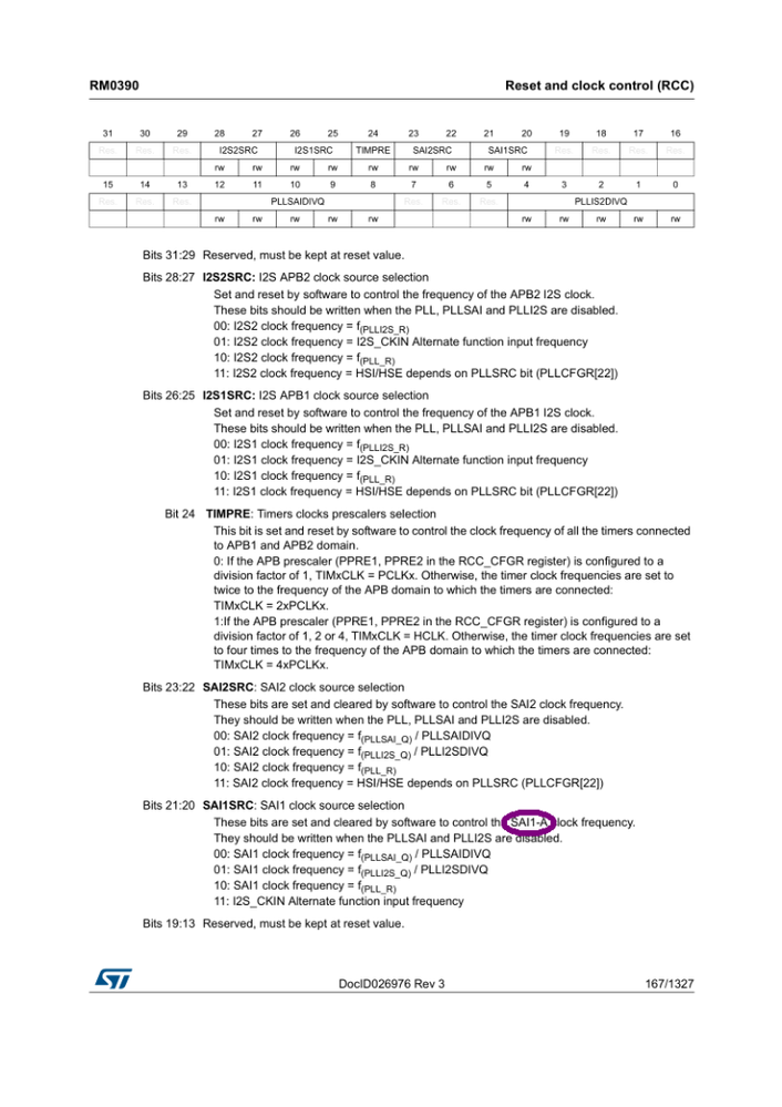

Is this a typo, or are there some other register bits which allow to select the source of the SAI1-B clock frequency?
2018-01-03 6:26 AM
Hello
Waclawek.Jan
,I confirm this typo, it should be SAI1.
I raised this typo internally to correct it in the next release of reference manual.
Thank you for highlighting the issue and sorry for any inconvenience it may bring.Best Regards
