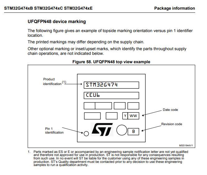

2020-10-16 2:35 PM
2020-10-16 2:44 PM
Here, Rev code is written as "Z" next to the text ARM. Likewise, it says "Z" on the G474 chip. Rev code "Y" on G431CBU.
I am having difficulty determining the Revision code because it says below in the datasheet.
If Rev X is coming out too far I'll have to go over the MCU options.
