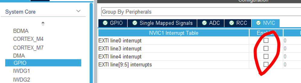

In GPIO, go to the NVIC tab and enable the interrupts.

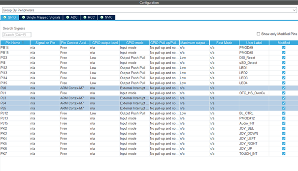

I generated the app with CubeMX but it did not generate the interrupt setup and handlers. Here is the screenshot of CubeMX:
0693W00000D1KFtQAN.pngThanks again,

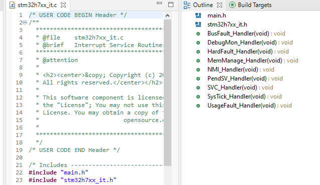

Well, the whole STM32H7xxx is too foggy to me to be sure, However in the*_it.c I found these functions only:
0693W00000D1KJMQA3.pngI attached the *.ioc file.
Also, defining user labels with a "#" in the name is no recommended. Might work, might not.

Hi TDK!
Thank you very much, it is working just fine. Thanks for your help. I appreciate it very much!
