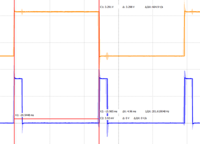

2023-12-13 12:08 PM
It worked! It was alot faster! Had to just figure out why my interrupts acted strange, and the software version got fast enough.
Blue is Time to copy.
Orange toggles between half full and full interrupts.
