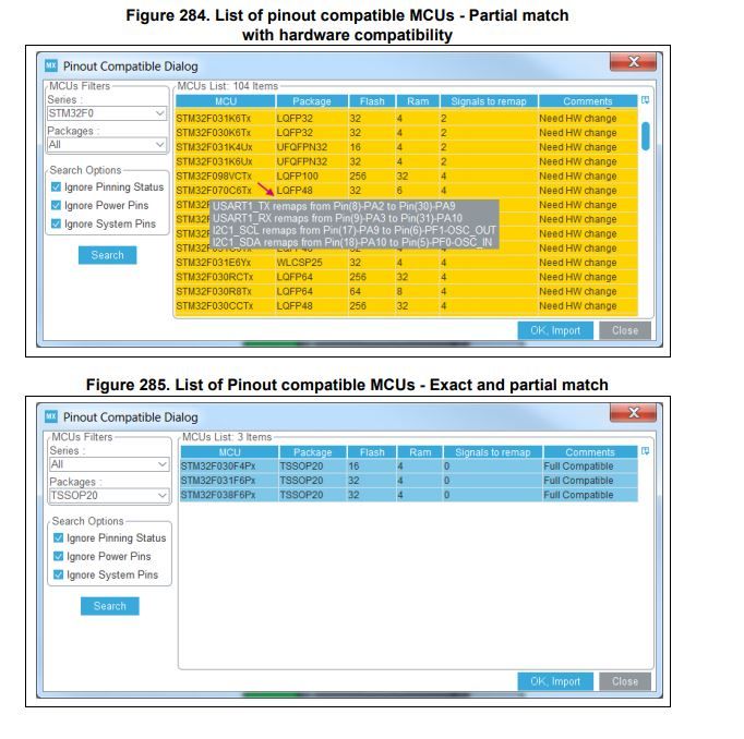

Hello @SHugh.2 ,
You can use the feature "List pinout compatible MCUs" within STM32CubeMX tool, it shows the pinout compatibility (which signals can be assigned to the exact same pin location)
For more details, please refer to the Tutorial 5: Exporting current project configuration to a compatible MCU section, in the UM1718.
