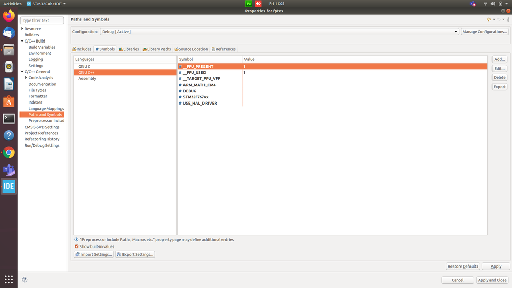

i = 0;I also setup the flags
But the time taking to execute the task is same as before setting up the above flags .
I was under assumption that once flag is set all legacy c defined math operation will be converted in FPU using code ? Am I wrong in the assumption ?

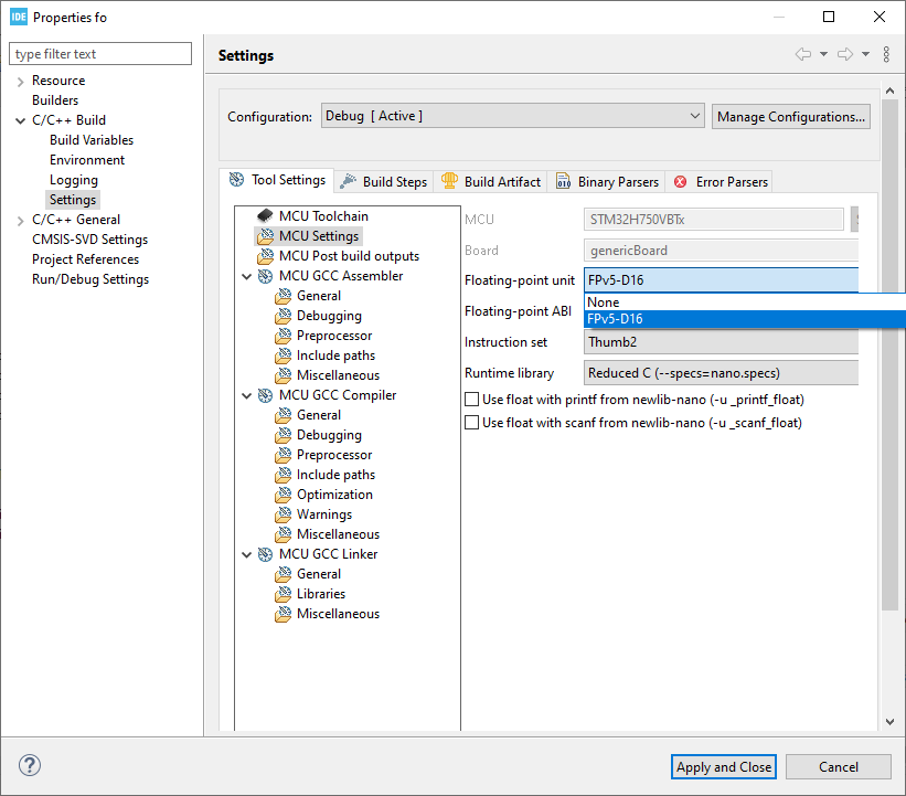

I think that FPU is used regardless of __FPU_PRESENT symbol, because it is already defined in
"\Drivers\CMSIS\Device\ST\STM32H7xx\Include\stm32h750xx.h" (this path for STM32H750):
#define __FPU_PRESENT 1 /*!< FPU present I think you can evaluate non-FPU performance by setting Floating-point unit to "None":
And maybe some additional changes to HAL driver defines.

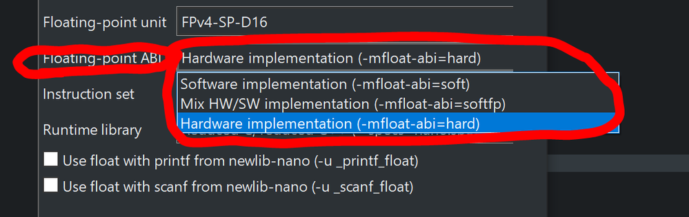

whats the difference between FPU andFloating point ABI ?
2022-01-24 5:10 PM
DSP and FPU are independent. Use of one does not require or imply use of another.
The "Floating point ABI" is the correct place to set whether the compiler creates FPU instructions or emulated floating point support.
