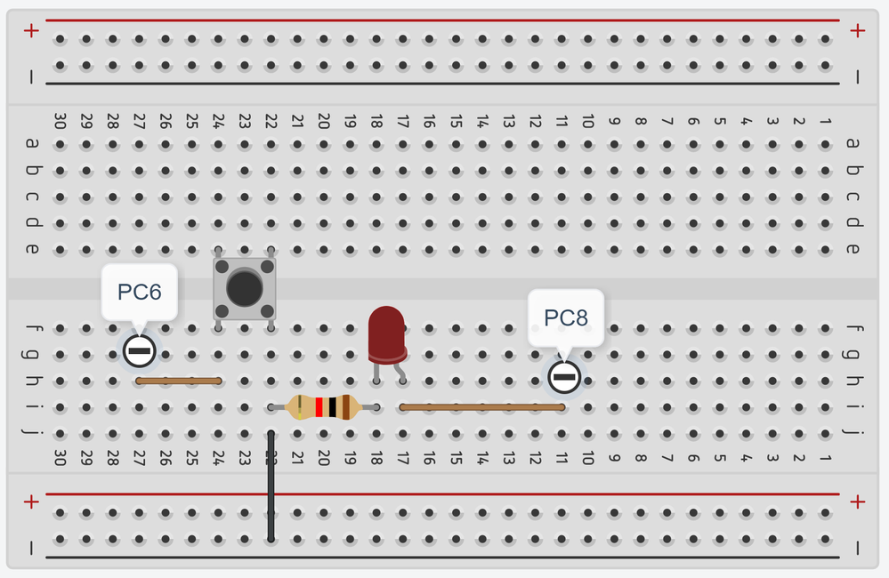

I am using a NUCLEO-L476RG development board, I am learning to write GPIO drivers for STM32 family I am implementing a simple logic in which I need to turn on an LED when a push button is pressed.
I have a strange issue: The Bread board LED turns ON when the line temp=10 line is commented, it doesn't turn ON when the line temp=10 is uncommented.
What could be the issue?
The issue doesn't solve after changing the location of the line
The connection to the bread board looks like the image below , I have not configured any clock source in my code, meaning it would take the default clock(MSI at 4MHz) for its operations. I have powered it using the Mini USB

2022-01-30 1:36 AM
Do you have a debugger?
Does the Nucleo LED keep toggling?
What happens if you make temp global, i.e. define it outside main()?
