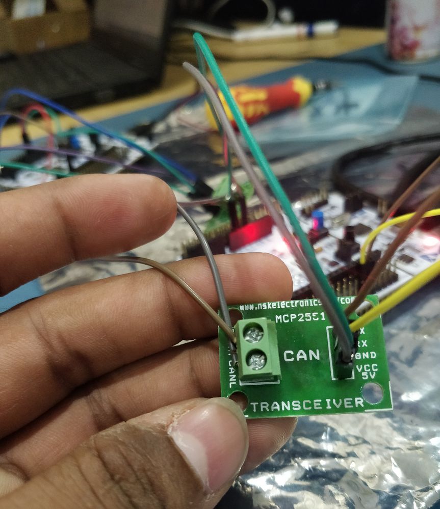

2018-10-29 2:56 AM
I am using network example with two evaluation board along with MCP2551 CAN tranceiver. One board I configured as tx and another as rx, but I am not able to receive the data in Rxdata buffer
suggest me something.

2018-10-29 3:28 AM
Don't the EVAL series boards have CAN ports and transceivers already?
What board specifically do you have? A DISCO or NUCLEO?
2018-10-29 3:36 AM
No CAN transceiver. It is NUCLEO. MCP2551 CAN tranceiver I am using.
