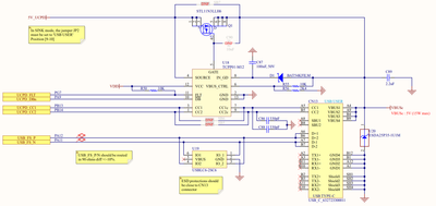

Hi @Deep_bang
If you are using Type C connector, you can follow the example provided in schematics.
Also, check the following FAQ on Vbus sensing
Management of VBUS sensing for USB device design - STMicroelectronics Community
