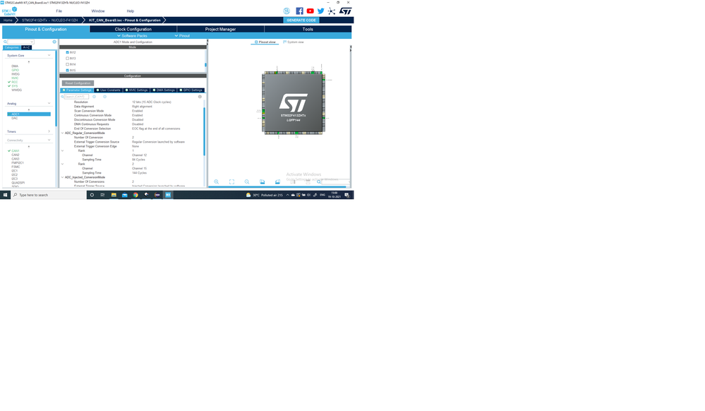

Code for reference @Georgy Moshkin
Image is also attached below

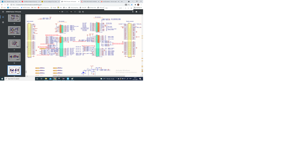

for more infor refer below image ; STM32F413ZH Tx Nucleo
@Georgy Moshkin

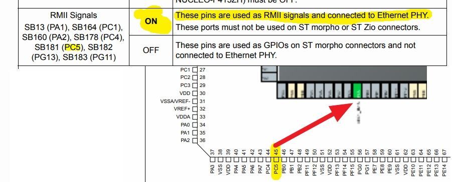

Please check UM1974 manual Table 12. Solder bridges:
From your image it seems that you use following pins for ADC:
PC2 ADC123_IN12
PC5 ADC1_IN15 - this pin connected to ethernet PHY using solder bridge SB181.
Solder bridge must be removed if you want to use this pin as ADC input on PC5. Note other solder bridges too.
