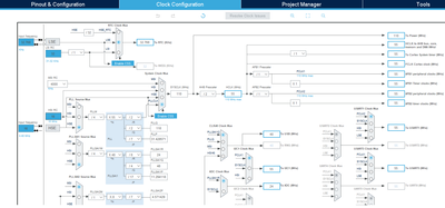

My board is STM32L552E-EV with STM32L552ZE MCU, yes in the example is the same microprocessor. I have this tab so how can I generate identical code in the example ?
How to select the HSI and configure the clock system to have the same code ?

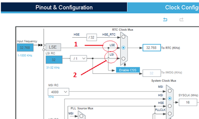

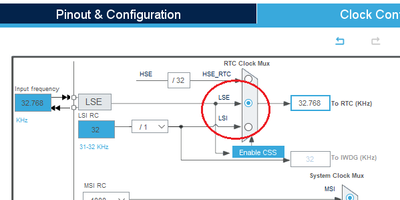

first, I would like to have these 5 lines,
And after trying several options it seems to me that it's impossible to have LSI and LSE at the same time
Did I miss something ? Here is my configuration in this attached, can you tell me where the errors are ? Thank you

What you have circled in the RTC clock selection. You can't have the RTC run from LSE and LSI at the same time.
If you use LSI somewhere in the system it will be automatically enabled in CubeMX.

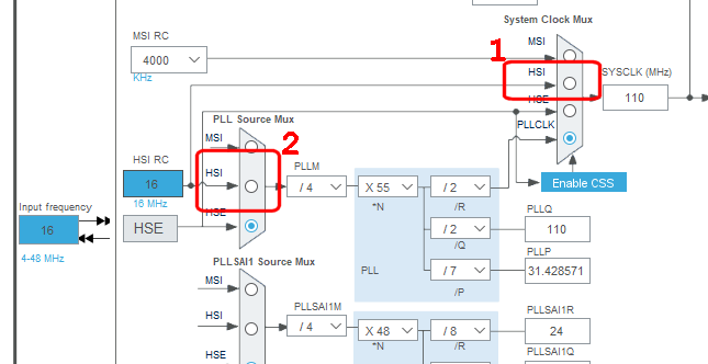

@DYann.1 wrote:How to select the HSI ...
As you can see in the diagram, you have two options:
@DYann.1 wrote:
... and configure the clock system to have the same code ?
Just make the settings the same as in that example.

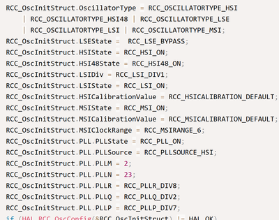

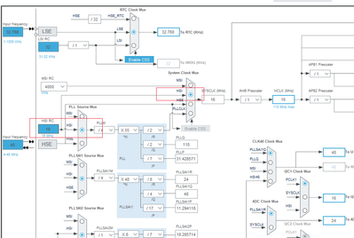

After making the changes
I have this code :
RCC_OscInitStruct.OscillatorType = RCC_OSCILLATORTYPE_HSI48|RCC_OSCILLATORTYPE_HSI
|RCC_OSCILLATORTYPE_LSE|RCC_OSCILLATORTYPE_MSI;It's not really the same like this one :
| RCC_OSCILLATORTYPE_HSI48 | RCC_OSCILLATORTYPE_LSE
| RCC_OSCILLATORTYPE_LSI | RCC_OSCILLATORTYPE_MSI;RCC_OSCILLATORTYPE_LSI is missing. How to do that ? Is it really important ? After my understanding
you can have one or the other but not both at the same time, Right ? :

2024-12-20 3:50 AM - edited 2024-12-20 3:52 AM
Were you sure to save those settings, and to re-generate the code?
Please post the .ioc file.
PS:
As @TDK noted earlier, are you sure the code that you showed relates to the System clock - not the RTC ?
Show the full code.
