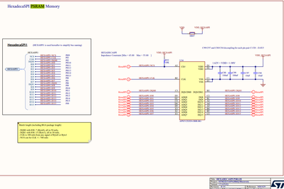

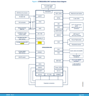

KDJEM.1
Hello @JKim.2,
For STM32U5A9J-DK board, the PSRAM is connected to HSPI1 interface not to OCTOSPI1 interface, as mentioned in the schematic and user manual of board.
 The HSP1 addressable space is from 0xA000 0000 to 0xAFFF FFFF not 0x9000 0000 to 0x9FFF FFFF.
Thank you.

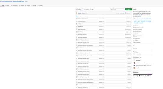

The main.h file includes many other header files including stm32u5x9j_discovery_hspi.h but they are not found. How to get them and successfully complete compilation?
STM32CubeU5/Projects/STM32U5x9J-DK/Examples/BSP/Inc/main.h at main · STMicroelectronics/STM32CubeU5 · GitHub
#include "stm32u5x9j_discovery.h"
#include "stm32u5x9j_discovery_conf.h"
#include "stm32u5x9j_discovery_ospi.h"
#include "stm32u5x9j_discovery_lcd.h"
#include "stm32u5x9j_discovery_ts.h"
#include "stm32u5x9j_discovery_hspi.h"
#include "stm32u5x9j_discovery_mmc.h"
#include "stm32u5x9j_discovery_ranging_sensor.h"
#include "stm32u5x9j_discovery_env_sensors.h"
#include "stm32_lcd.h"
Thanks.
KDJEM.1
Hello @JKim.2;
Are you having a compilation error? If yes, please create a new message with a description of the problem.

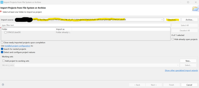

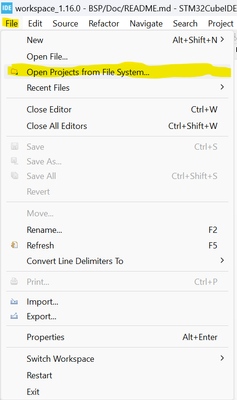

You can find these header files in \STM32Cube\Repository\STM32Cube_FW_U5_V1.7.0\Drivers\BSP\STM32U5x9J-DK (GitHub - STMicroelectronics/stm32u5x9j-dk-bsp at a5723a4ff404cb659b3c095d59527a0b0c2062f0)
To, open BSP example, please follow these steps:
I hope this help you.
Thank you.
Kaouthar
Hello @KDJEM.1 ,
The header files can be included in my project and the OSPI_RAM_demo example at HSPI configuration can be executed w/o issue. Thank you so much.
