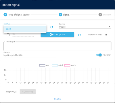

In this step, I wanted to acquire the data directly on NanoEdge Studio AI, but the COM port of the STWIN.box is not recognized, so acquisition is impossible.
I understand that the firmware uses a DFU mode and not a CDC so windows 10 doesn't recognize it. Is this correct? If so, how can I change this?

referring also to this, this and this, DATALOG2 firmware for STWIN.box is not streaming data via UART (VCOM port) from STLink.
For DATALOG2, developed a specific USB class (the Multi_Sensor_Streaming you already highlighted) that allow the firmware streaming data up to 6Mbps.

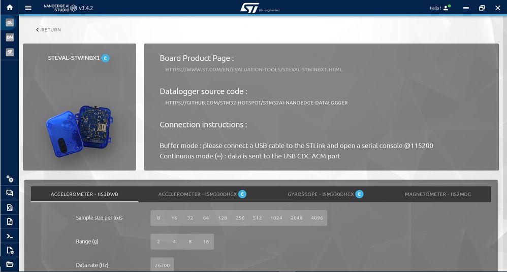

DATALOG2 is not the Datalogger used in NanoedgeAIStudio, as stated here in the tool:
If you would like to use the NanoedgeAIStudio online logger, you must manually flash the proper STM32-NANOEDGE-DATALOGGER firmware from the github link available in the tool on the STWIN.box before using the board.
This STM32-NANOEDGE-DATALOGGER is streaming data via UART (VCOM port) from STLink.
