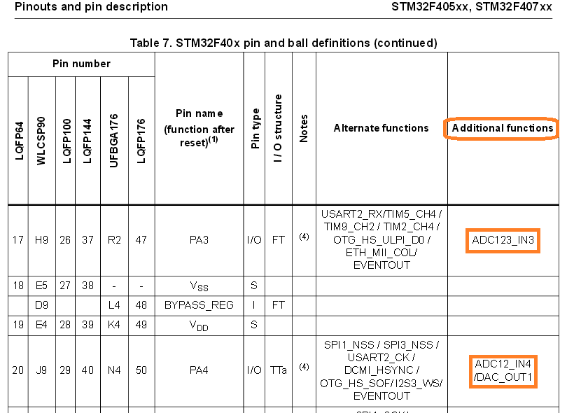

Could you tell me where in the manual that tells me the mapping from a GPIO pin to an adc channel? I am having a hard time finding it.

Analogue functions are treated slightly differently than Digital AF/GPIO ones
void GPIO_Configuration(void)
GPIO_InitTypeDef GPIO_InitStructure;
RCC_AHB1PeriphClockCmd(RCC_AHB1Periph_GPIOA, ENABLE);
/* Configure ADC1 Channel3 & 5 pins as analog input ******************************/
GPIO_InitStructure.GPIO_Pin = GPIO_Pin_3 | GPIO_Pin_5;
GPIO_InitStructure.GPIO_Mode = GPIO_Mode_AN;
GPIO_InitStructure.GPIO_PuPd = GPIO_PuPd_NOPULL;
GPIO_Init(GPIOA, &GPIO_InitStructure);
2014-03-21 7:41 AM
thank you so much
