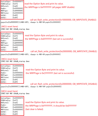

Hi @Amel NASRI, thanks for your reply!
I already referenced this example before I posted this question. Anyway, I reread it and wrote the test demo as follows:
* @brief set Flash pages WRP state
* @param pages @ref FLASHEx_OB_Write_Protection in stm32f1xx_hal_flash_ex.h
* @param wrpSta @ref FLASHEx_OB_WRP_State in stm32f1xx_hal_flash_ex.h
* @note each bit in WRPPage means one page: 1 is mean this page's WRP is disable, and 0 is mean enable
* @note can NOT clear the WRP of part pages, only clear ALL!
void set_flash_write_protection(uint32_t pages, uint32_t wrpSta)
HAL_StatusTypeDef hal_sta = HAL_OK;
FLASH_OBProgramInitTypeDef OBInit = {0};
HAL_FLASHEx_OBGetConfig(&OBInit);
LOG_DBG("pagesSta[0x%08X](1=WRP-OFF), change to WRP-%s pages[0x%08X]\n", OBInit.WRPPage, wrpSta?"ON":"OFF", pages);
if(((~OBInit.WRPPage & pages) != pages) && (wrpSta == OB_WRPSTATE_ENABLE)) {
HAL_FLASH_Unlock();
HAL_FLASH_OB_Unlock();
OBInit.OptionType = OPTIONBYTE_WRP;
OBInit.WRPState = OB_WRPSTATE_ENABLE;
OBInit.WRPPage = pages;
hal_sta = HAL_FLASHEx_OBProgram(&OBInit);
if(hal_sta == HAL_OK) {
HAL_FLASH_OB_Launch();
} else {
LOG_ERR("set Flash WRP err[%d]\n", hal_sta);
} else if(((OBInit.WRPPage & pages) != pages) && (wrpSta == OB_WRPSTATE_DISABLE)) {
HAL_FLASH_Unlock();
OBInit.WRPState = OB_WRPSTATE_DISABLE;
} else {
LOG_ERR("clear Flash WRP err[%d]\n", hal_sta);
}The LOG as below:
My code is almost the same as the example, but why can't it work?
