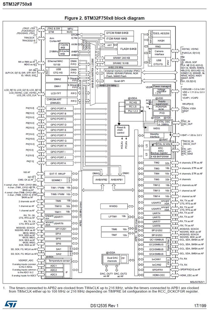

Depends on what APB1 is set too, most systems it is usually DIV2 or DIV4, as APB2 is the faster bus
The system block diagram from the data sheet might be what you need to review.
2019-07-15 6:03 AM
I see thanks. I am not familiar with STM32 architecture so I not even thought looking at the main diagram, I am coming from the PIC world :)
