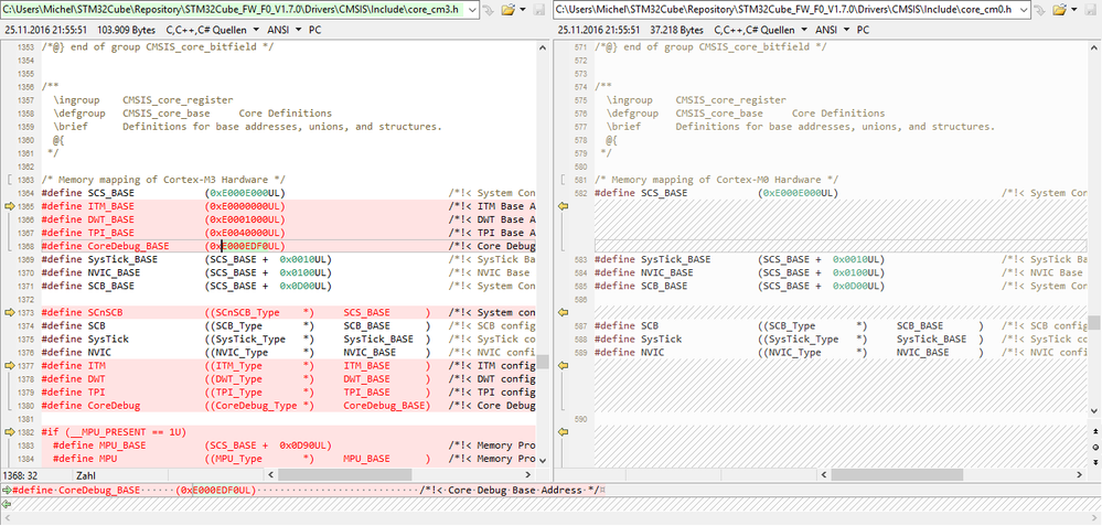

Also the CMSIS register header file shows a lack of the CoreDebug_BASE register
Is this feature simply not available for a M0 device ???

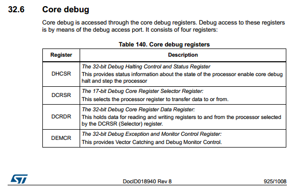

In any case I'm very confused to find a chapter 32.6 Core debug in the
reference manual which are obviously not available:2017-01-18 8:24 PM
The feature exists - but the register is not accessible to the user code running in the chip.
