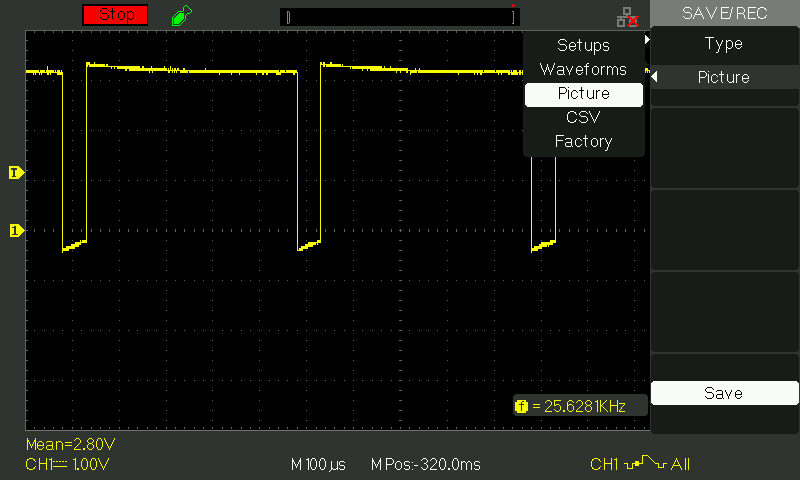

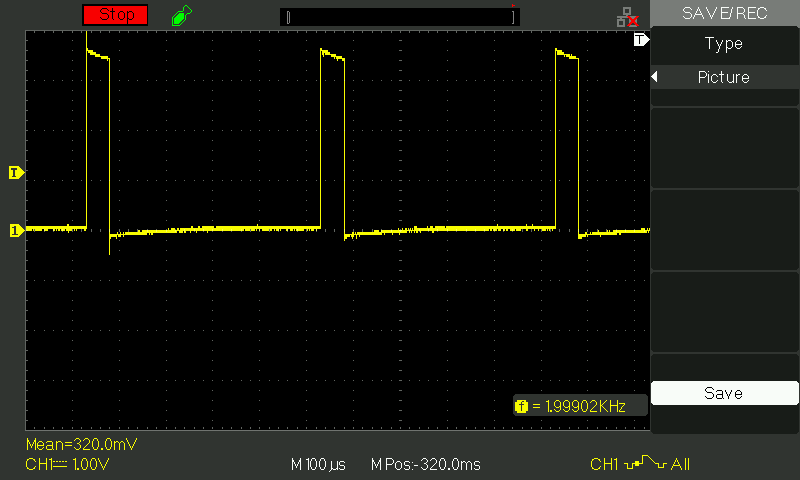

I want to change my PWM signal as pictures:
2020-05-09 12:17 PM
What have you tried exactly?
What is on those waveforms you posted? Which pin and how exactly did you generate those waveforms?

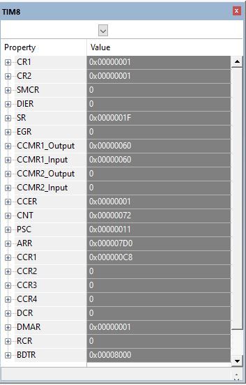

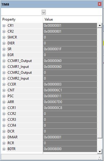

Read out content of the TIM registers before the change and after and compare/post together with respective waveforms.

I want to change my signal as pictures with a command, I have used both thses code to change polarity, CC1P in CCER changes but signal doesn't change:
TIM_OC1PolarityConfig(MAN_PWM_TIMER,TIM_OCPolarity_High);MAN_PWM_TIMER->CCER ^= TIM_CCER_CC1P;I have defined another function called PWM_change & DeInit Timer and change Output Compare Configuration as below, other configuration is the same as PWM_Init():
ocx.TIM_OCMode = TIM_OCMode_PWM1;
ocx.TIM_OutputState = ENABLE;
ocx.TIM_OCPolarity = TIM_OCPolarity_High;
ocx.TIM_OCIdleState = TIM_OCIdleState_Reset;
ocx.TIM_Pulse = 200;
TIM_OC1Init( MAN_PWM_TIMER, &ocx );and it works calling PWM_Change() instead of changing Polarity. Bad story is it doesn't work when I remove DeInit function from first part of PWM_Change() function.
And I need use PWM signal in a PID controller and can not Init & DeInit Timer everytime.
I look for a better way to change PWM signal.
2020-05-10 3:33 AM
CC1P in CCER has changed that is normal but OIS2 in CR2 has changed too.
2020-05-10 5:20 AM
OK so now if you perform the same change by directly writing to registers, you will see the waveform changing in the same way too.
To try it, you don't need to write any code, simply change it directly in the debugger.
