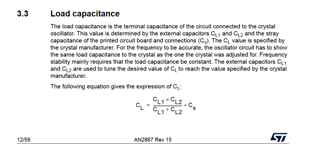

2021-10-28 3:38 AM
Thank you. I just found this Infomation in "Oscillator design guide for STM8AF/AL/S, STM32 MCUs and MPUs"
