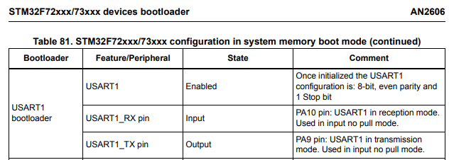

General programming could be done via a serial port, or USB. See App Note AN2606

I was checking the APP Note AN2606, so using USART1 (for example) we can flash/debug the MCU, boot0 (PIN 138) must be connected to GND, so, Main Flash memory is selected as boot space.
So, the ST-LINK V2 (wired as TX-RX(MCU), RX-TX(MCU), GND-GND(MCU) and VDD-VDD(MCU)) using pins: PA10 and PA9, it should work
I hope I understood correctly, if not please, let me know it...
