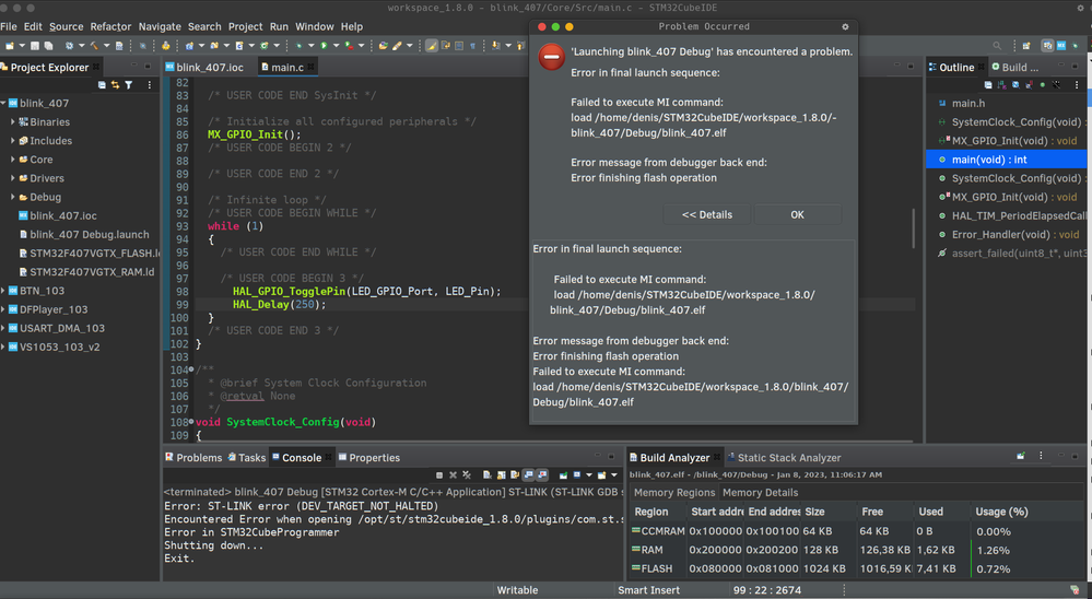

I have STM32F407VG board and it has error in flashing time see screen.
I have STM32F407VG board, and it has error in flashing time see screen. Yesterday was everything ok but today is broken, I don't know why!
I found a solution https://community.st.com/s/question/0D53W00000V0NbvSAF/got-error-like-stlink-error-devtargetnothalted-when-to-flash-the-program

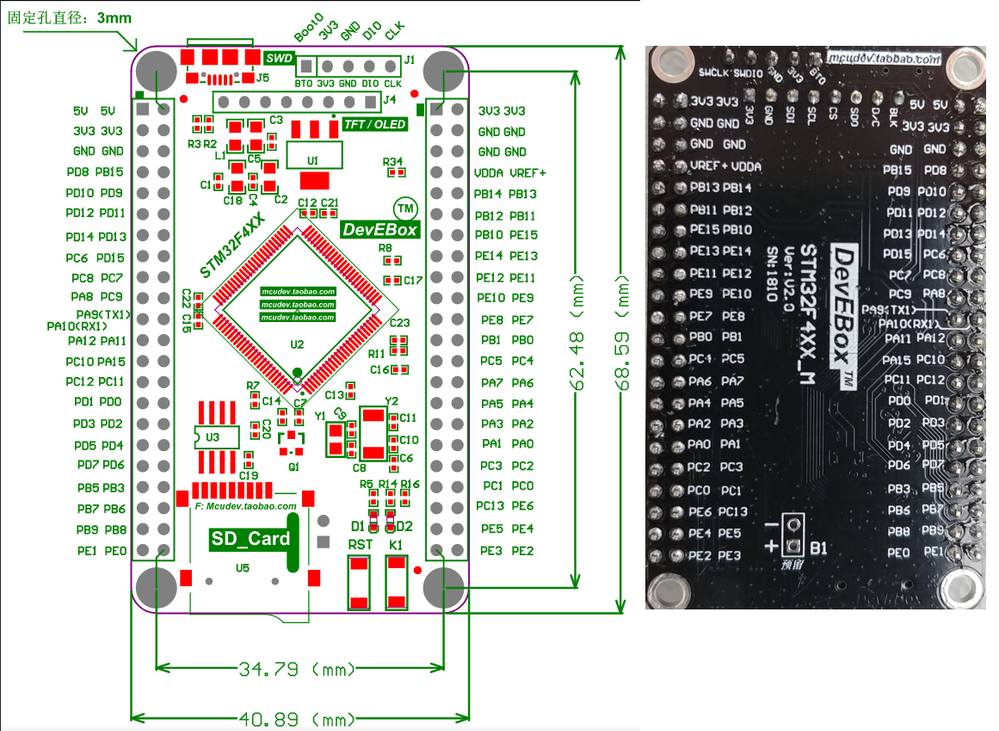

but my board doesn't have a pin "VDD", see screen.
And second, misunderstanding what is mean "(hope you are using boot selection through Boot 0)."?

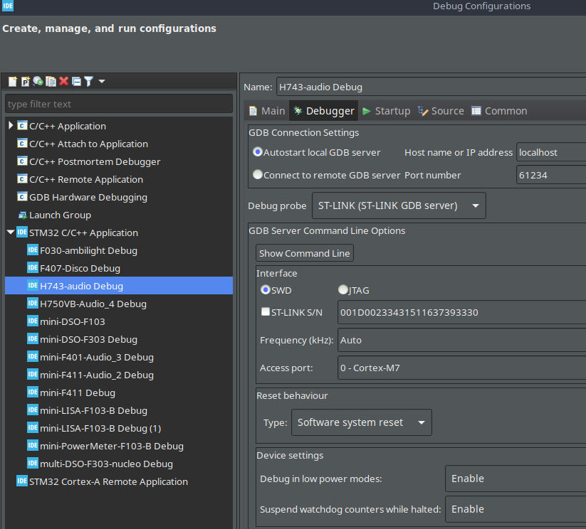

in the settings, where you adjust, how debug should start..
in IDE menu (run)-> debug configurations... (your project)-> Debugger -->
here: softw.sys.reset

VDD =3.3V , on your board; for bootloader mode just set a jumper on B0+3v3 pins.
but first try debug with setting "software system reset" and "connect under reset" ;
if nothing starts debug connection,
power off ! ,
put the jumper on B0+3v3 ,
then power up
and try debug again...

2023-01-08 9:52 AM
