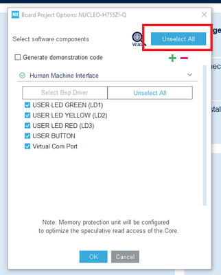

Hello @smallkitties3 and welcome to the community,
Simply, click on "Unselect All" button to prevent CubeMx to generate the BSP code and configure the GPIOs according to your needs.
I've attached a project where Green, Red, Yellow leds are toggling on NUCLEO-H755 board. The project was generated with CubeMx v6.13 starting from a the board (Bsp generation disabled from the beginning).
Hope that answers your question.

2024-12-19 1:03 AM - edited 2024-12-19 2:46 AM

2024-12-23 1:21 PM
Hello SofLit,
Thank you for this suggestion and attaching the project. However, the process in suggestion masks the process of configuration and the Categories section (in Pinout & Configurations tab) still has the BSP listed as a remanent.
The very purpose for purchasing this development/discovery board was to learn how to design and program the onboard dual-core.
Thank you for your reply and welcome.
