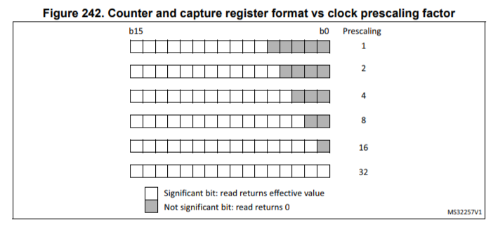

The reason why I'm asking is "Figure 242. Counter and capture register format vs clock prescaling factor" from the manual of STM32F334xx.
It essentially states, that when I multiply clock f_HRCK by factor 2, I lose one bit of precision. So the actual PWM time precision stays the same regardless of the f_HRCK.

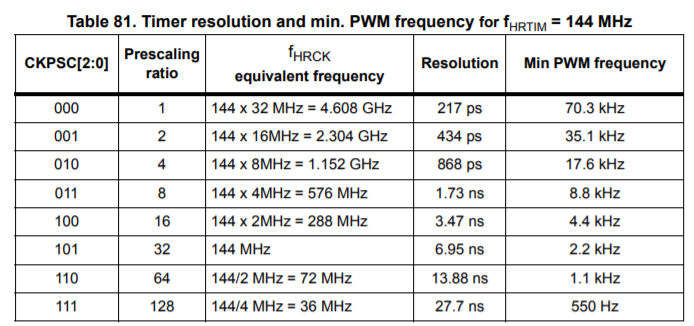

Or following this table:
If I have configured HRTIM with maximum equivalent frequency of 4.608 GHz (CKPSC = 000), then I can specify period and compare register only in values multiple by 32, since all 5 LSB bits became disabled/not significant (according to Figure 242). As a result I still have 217ps * 32 = 6.95ns effective time resolution, as it is without frequency multiplication of the clock (when CKPSC = 101). So I cant use the advantages of this high frequency clock and claimed 217ps resolution.
Am I missing something?
