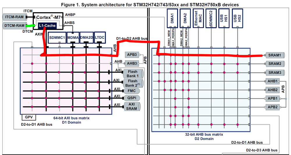

How many clock cycles should it take to write to AXI SRAM from the M7 core, assuming that the cache is disabled (and disregarding instruction pipelining)?
The reference manual says:
"The system AHB SRAM can be accessed as bytes, half-words (16-bit units) or words (32-bit
units), while the system AXI SRAM can be accessed as bytes, half-words, words or double-
words (64-bit units). These memories can be addressed at maximum system clock
frequency without wait state." [emphasis mine]
I assume that accessing the AXI SRAM isn't always zero wait state because:
I'd love to confirm the results of my testing with hard numbers from the reference manual or an application note, or other credible source.
Thanks,
Richard
2021-06-14 2:16 PM
The M7 is complicated and there isn't a simple answer for this. The behavior of the busses is certainly not documented in detail anywhere that I have found.
Might be more a result of the SRAM being separated from the core by 2 busses, whereas the DTCM is directly connected.
You may find this of tangential interest:
https://www.quinapalus.com/cm7cycles.html
2021-06-14 2:34 PM
The AXI SRAM is on the near side 64-bit bus, but is dual-ported
Honestly not sure one can simply ignore the pipelining and write-buffer.
The throughput it probably more critical than the latency.
Perhaps should look at 8-byte aligned STRD/LDRD vs those at +4 offset and spanning
ITCM/DTCM also doesn't pollute the cache, or have external bus contention.
