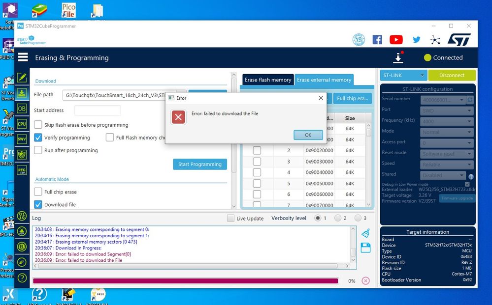

2023-07-19 11:03 AM
I made this project with CUBEIDE, but it gives the error in the photo!
2023-07-19 11:38 AM
Suggest outputting at Verbose Level 3 to understand what STM32 Cube Programmer is attempting exactly.
Instrument you own loader so you can get diagnostics / telemetry out of a serial port whilst STM32 Cube Programmer is calling and interacting with it's interface routines.
