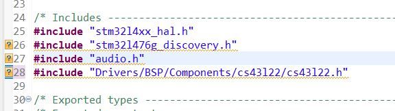

I have tried everything I can think of and the program won’t link the header files. I am have tried to add the header files to the project but lots of issues arise. I have read and understood that driver files cannot have their file directory disrupted.
2020-12-06 7:36 AM
Did you follow the advice in your last thread? What is the full path to audio.h and cs43l22.h? What are you project include directories?

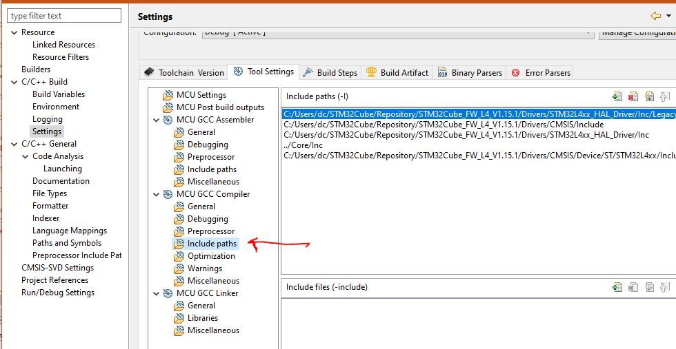

Hello
make a new include path to your headers . MENU>PROJECT>PROPERTIES
2020-12-06 8:19 AM
Yeah, i have tried everything I can think of too.I just replaced the #include header files with the source code from the header files themselves. The same errors apeared from 3 HAL drivers, they are HAL_dfsdm, HAL_sai.h and HAL_uart.h. The errors were from the #include header files for each of the drivers.I have tried to replace the #include for each of the 3 drivers with the source code from the .h files for each driver, but 17 errors apear.
I dont know what else i can do becasue I have tried everything I can think of. I fully appriciate your help, thanks again.

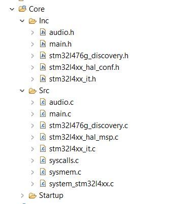

2020-12-06 11:25 AM
The include files describe the interfaces, you have to actually pull the .C files in with the library code within them into the project.
2020-12-07 2:48 PM
Thanks very much for your help.The mic and the headphones are now working on the board when the program runs.I added the header files and c files as you advised and the program went to the microcontroller with no issues.The LCD screen is not working on the recorder. Do you know how I enable it? I have checked the jumper arrangements and they are alright. I have held the joystick down like the manual advises but it will not operate.Are there more files required to get the LCD screen operational?
