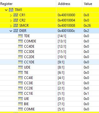

> The code for the Interrupt is generated in the stm32h7xx_it.c file "(void TIM1_UP_IRQHandler(void))" but execution does not appear to reach it.
How do you verify that?
Read out TIM1_DIER and make sure the UIE bit is set in it.
Make sure "TIM1_UP_IRQHandler" is spelled correctly, check that it matches the spelling in the startup code. Check in disasm that this routine's address is present at the correct address in the interrupt vector. Some other interrupt-related hints here.

2021-04-16 3:19 PM
The UIE bit for DIER for TImer 1 is set to zero.
2021-04-16 4:04 PM
Well, then TIM1_UP_IRQHandler() won't be called.

2021-04-16 7:24 PM
Just for reference, the work-around is to write directly to the TIM1 DIER register with the bits set to 1 for CC1IE and UIE to turn on both the Capture/Compare Interrupt and the Update Interrupt.
Place this instruction after the Cube IDE generated code so that it overwrites the incorrect Cube IDE settings.
/* USER CODE BEGIN TIM1_Init 2 */
TIM1->DIER=0x3;
/* USER CODE END TIM1_Init 2 */

2021-04-22 5:53 AM
HAL_TIM_Base_Start_IT does indeed set the UIE bit in the DIER register but I need to generate a PWM pulse output with timer 1, so I can't use HAL_TIM_Base_Start_IT.
When I use HAL_TIM_PWM_Start_IT, it should also set the UIE bit to one but it doesn't. I assume this is a bug in CubeMX.
To fix this, I write directly to the DIER register using TIM1->DIER=0x3; right after the HAL_TIM_PWM_Start_IT instruction. That sets the UIE bit to one and the interrupts then work.
