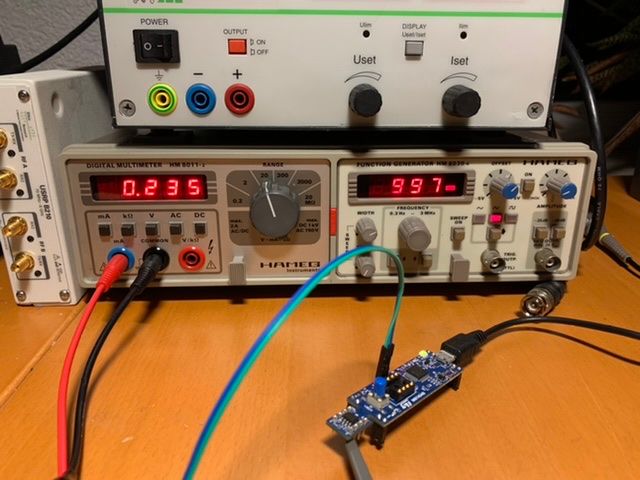

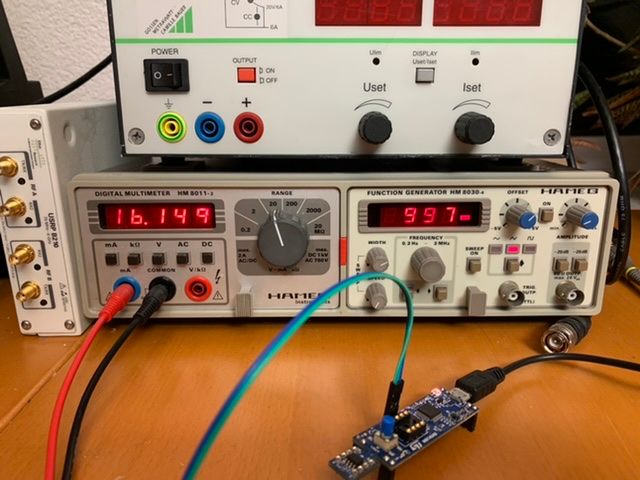

That was exactly my thought too. The hardware runs reliably and more energy-efficiently at higher frequency on HSI oscillator. I also found it very shocking seeing STM's own example breaks all boundaries. Maybe a STM developer will read an comment.
STM-LSI-Example:
My HSI LowPower Test:
Hardware is an original new STM32G031-Discovery Board. There isn't any peripherlal hardware (besides LED and switch) on the board, only MCU and ST-Link.

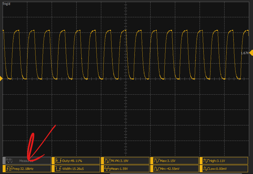

I have already tried everything: Blinky, MCO. Clock only. Everything is OK. MCO shows perfect LSI clock at 32 kHz. Better than expected. Measurement with and without Debugger (250 µA HSI measurement was done with Debugger).
Sys Clock LSI 32 kHz:
