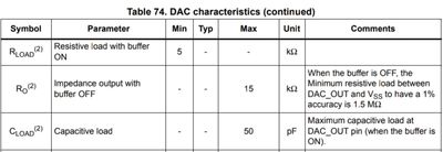

so this needs an output amp ! see ds , minimum load is 5K , with buffer ON .

As @AScha.3 Said, you should use a Resistive load of 5K ohm minimum and a Capacitive load of maximum 50pf (with buffer ON).
For more details, take a look at the part 5.3.25 of the DS8626.

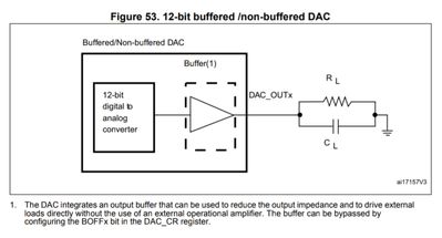

As you Can see under the figure53:
"The DAC integrates an output buffer that can be used to reduce the output impedance and to drive external loads directly without the use of an external operational amplifier".
I think this answer your question.

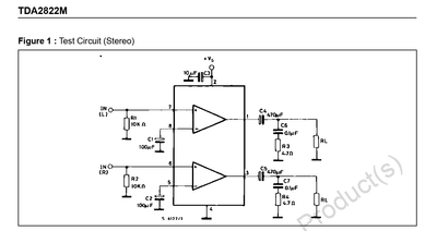

no, nothing to add! the amp should have high-impedance input , minimum is 5k .
so you want drive a speaker ? then you need a small power amp.
ie...
