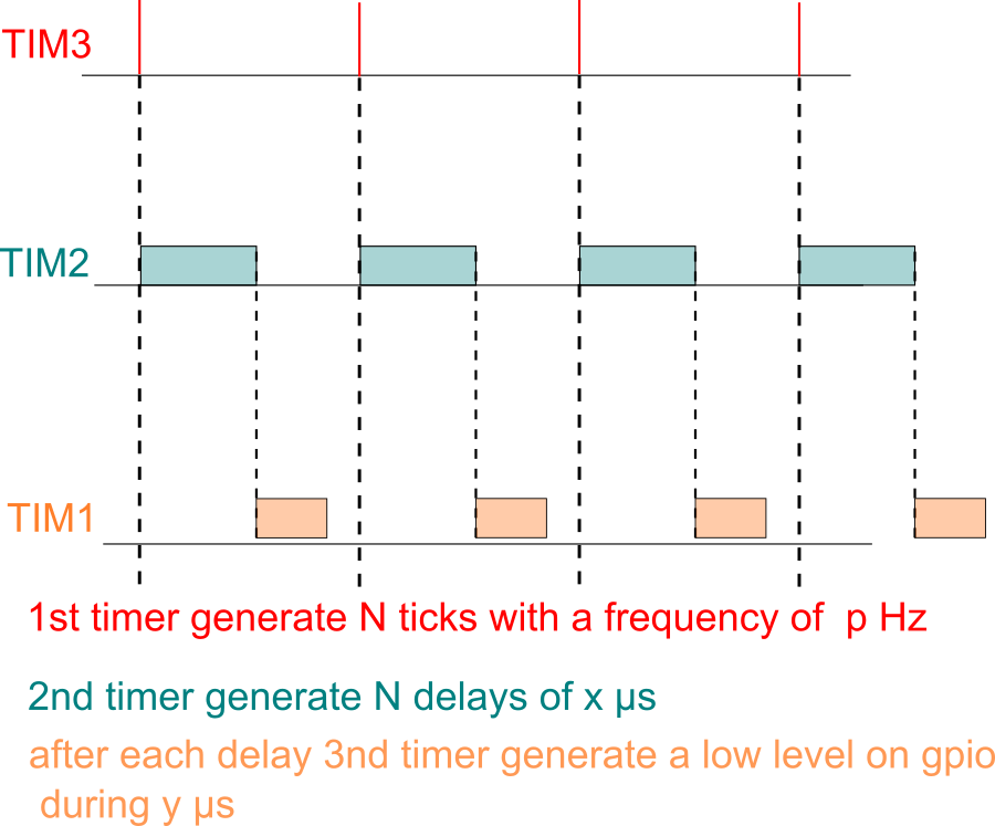

2019-02-12 2:15 PM
this is a diagram of i want. TIM3 can be replace by an external trigger with ETR entry of TIM2. The numbers : N, p, x and y are the parameters of this process.
Ludovic
2019-02-15 12:02 PM
For this, you don't really need master-slave. If you trigger TIM1 directly from the first line signal (whether coming from TIM3 or externally), running it in PWM2 mode, or simply inverting its output, and using one-pulse mode, you should be able to achieve this waveform.
