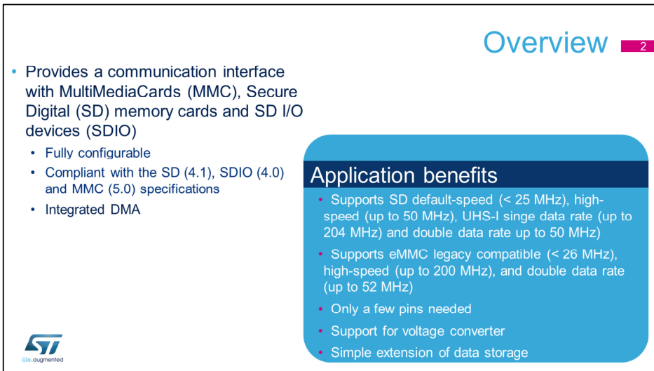

I am using STM32h743bit6.
How can I measure sd card default speed?
SDIO_CLK?
SDIO_CMD??

Measure it, or compute it?
You can unpack the source speed via the RCC selection and pll settings, and how it's divided via SDMMC registers.
Scope SDIO_CLK during interactions.
I suspect 200 MHz operation on the wire is somewhat fanciful as electrically this would be quite challenging and the data volume close to unhandleable. Here I suspect it allows the use of both clock edges of a 100 MHz clock signal of 100 MHz on the wire if you can negotiate the memory into that mode and you have a transceiver.

Thank you for answer.
I want to measure.
