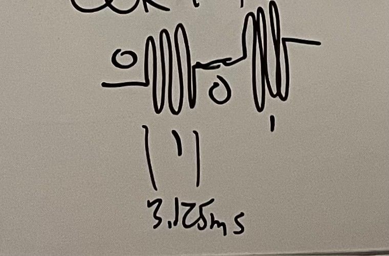

Hi everyone i'm new here with STM32 , I'm not really a programmer so I need some help.
my objective is generate sine wave with DMA DAC , I did that and I got my sine wave using FCLK with tim2 ( Iam using STM32F303K8 ) and now I want just to apply a delay for that sine wave for example 1ms on and 1ms off which mean 50% duty cycle , I read that I can apply another timer to create a delay with it , or directly call function HAL_Delay , thank you for your help
this is my code

2023-01-05 7:46 AM
Not really explained very well.
Perhaps diagram the signals, input vs output.
The sample rate can be drive by TIM.
Could you achevie the delay by controlling the phase of the data that is output to the DAC.
2023-01-05 8:12 AM
Actually, I want to modulate my 100 kHz sinewave to 320 bits per second, and the modulated message has to be repeated 10 times. Basically, I want to reproduce that data signal .
