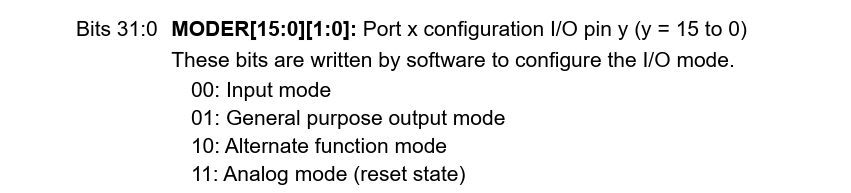

you can write direct to port set registers, this is fastest way to change outputs.

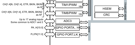

ports are on AHB4 , at 200MHz bus clk and higher cpu clk can expect 5ns action on port.
( highest speed setting, optimizer on , -O2 os -Ofast , prefetch and caches ON )
and just set outputs as you like and then set mode register to -> input. (tri state output)
write access example : GPIOB->MODER = 0x080E ;
In 'H7, writing from processor? Hardly so.
