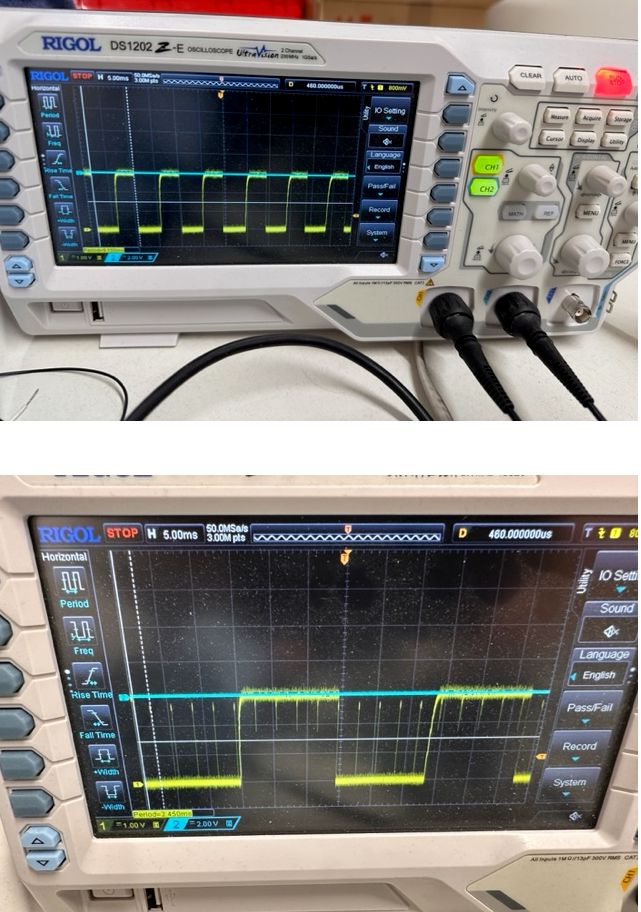

It turned out that each ADC read causes 28µs spikes occuring every 3ms in one of my encoder pulses of motor 1. (I scan the ADC every 3ms). Once i disable the ADC reads , the spikes disappear, and speed measurements stay stable.
The spikes become much bigger with 2 motors enabled which caused the input capture interrupt to trigger .
We took a look at the PCB at the encoder line we we don't see a posibility for crosstalk.

If the scope picture shows encoder signal + spikes, then the encoder signal routing seems to be good, but heck what spikes!
2023-02-07 11:00 PM
yeah, it almost look like the encoder inputs are briefly set as output.

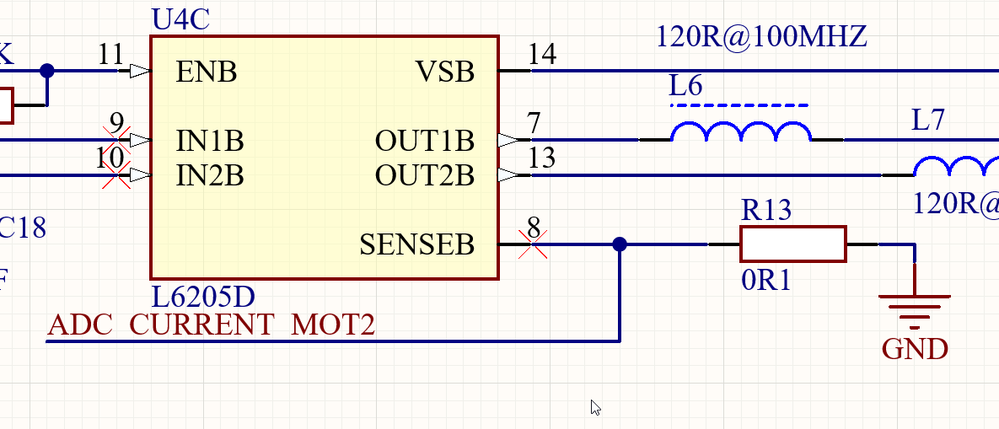

The adc goes directly to the sense resister of the motor driver without any cap, resistor ,
buffer or filter.
2023-02-08 1:41 AM
That's bad. An ADC is a switching device, esp. if it's working with a sample & hold circuit. Always put a capacitor to an ADC input.
I would put a small cap (depends on signal freq, but I guess 100pF .. 10nF would be okay) close to the STM32 ADC input, and - just in case - another cap parallel to R13.
Important: use C0G / NP0 caps.
