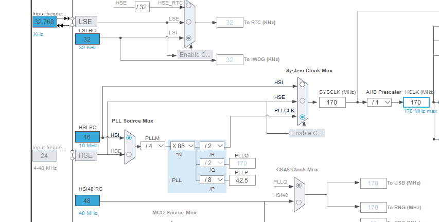

Does the HSE depend on the internal clock frequency of 170 MHz? Because the HSE is only 24 MHz. So what as example will decrease?
One can achieve 170MHz without the HSE present.
I would recommend looking at the clock tree in CubeMX or the reference manual for deeper understanding. Specifically the use of the PLL as a clock source and it’s possible inputs.

With the CubeMX it was possible to use the internal HSI and with the right adjustement of the dividers, it was possible to keep 170 MHz.0693W00000LwG7cQAF.pngThanks :)
