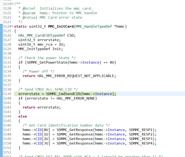

The first command gives response when I cup the power and put it back but the second one never give response

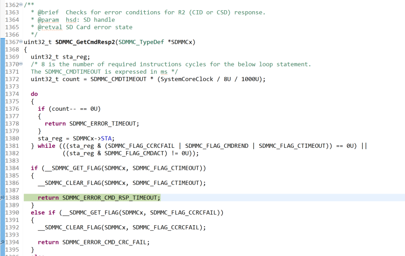

Not sure screen shots of library code are the path to success here.

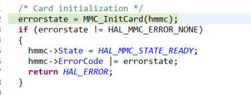

Maybe you can see the problem with that.
