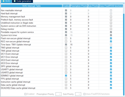

2025-08-04 4:17 AM
Hello @Saket_Om
I've added the FreeRTOS wit just a simple blink statement. That works just fine. Any suggestions to the interrupt priorities I should try out?
This is the working project:
2025-08-04 4:31 AM
Hellow @Saket_Om
Thank you for the suggestion!
I changed the priority of the TIM1 to 0 and now the MMC initializes, the RTOS is running and TouchGFX is showing images :)
