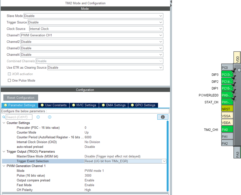

I have configured the peripheral with STMCube, as shown in the picture, but I have no output signal on the pin. I can see the TIM2_CNT is working and the CCR1 contains the coorect value

And the firmware use the instructions:
MX_TIM2_Init();
HAL_TIM_PWM_Start (&htim2, HAL_TIM_ACTIVE_CHANNEL_1);
but nothing happens on the pin. If I simply configure PA0 as a output push-pull it works, sothere are not hardware problems.

2020-11-12 6:57 AM
Hi, I made the correction you suggested but the result is the same.
I tried to change the setting of PA0 to open drain with pull-up but it still does'nt work and remains low.
Instead loading the PWM Output example for STM32L053 nucleo boards it works very well. I have checked that the configuration made in the example is slightly different from the code generated by MX.

2020-11-15 11:44 PM
Hi, I think I found the bug, the generated code of the PA0 did't comprehend the setting of alternate function, see the code as it was generated:
oid HAL_TIM_MspPostInit(TIM_HandleTypeDef* htim)
if(htim->Instance==TIM2)
/* USER CODE BEGIN TIM2_MspPostInit 0 */
/* USER CODE END TIM2_MspPostInit 0 */
__HAL_RCC_GPIOA_CLK_ENABLE();
/**TIM2 GPIO Configuration
PA0 ------> TIM2_CH1
GPIO_InitStruct.Pin = GPIO_PIN_0;
/* USER CODE BEGIN TIM2_MspPostInit 1 */
/* USER CODE END TIM2_MspPostInit 1 */
The raw:
GPIO_InitStruct.Alternate = GPIO_AF2_TIM2;
was missed.
