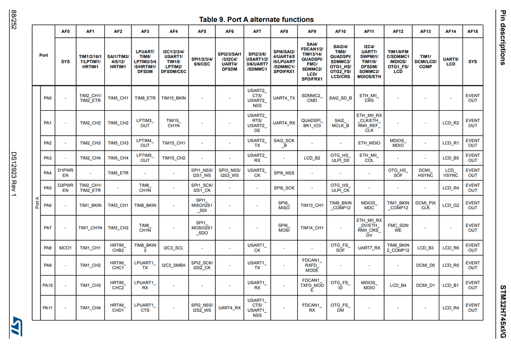

2021-12-20 12:16 PM
The datasheet will have that information.
https://www.st.com/resource/en/datasheet/stm32h745zg.pdf
For example, here is port A:

2021-12-21 12:00 AM
Thanks a lot, I've walked over it a thousand times without seeing it.
