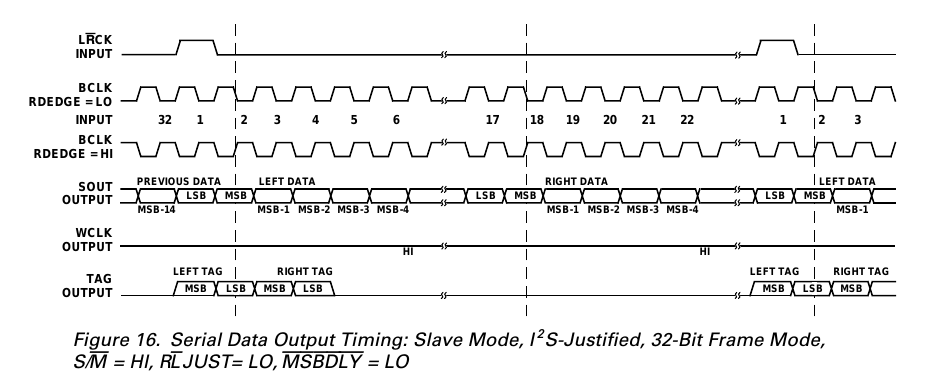

i have adc ad1877, configured as in picture2014-04-02 3:30 AM
The AD1877 is not crystal clear and I am not going to study it in depth, but I'd say you should use a standard I2S mode rather than PCM mode on the STM32 side (the datasheet says, that the mode displayed in Fig.16 occurs if LRCK is high for between one to 16 BCLK periods).
I assume you made sure you are in 256-CLKIN mode and you are aware of all gotchas of interfacing the STM32 to a 5V device. JW2014-04-02 3:45 AM

Whooops, sorry, I meant to write, the datasheet is not crystal clear (in that there are too many modes to understand it thoroughly just by quickly skimming the datasheet).
Nevertheless, it's clear that the ADC transmits 32-bit frames, whereas the I2S module in STM32 when set to PCM mode can receive only 16-bits per frame (even if set to the long 32-bit frames). That's why said you should start with setting it to standard Philips I2S mode. JW2014-04-02 4:34 AM
