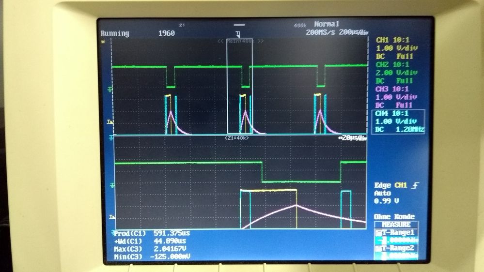

I am struggling to find how (or if) is possible to use the TIM1 (advanced control timer) of the STM32FG071 to run a hysteretic current regulator completely in hardware (without relying on software)
The idea is to use both comparators of the chip together with the 2 values of the DAC to set maximal e minimal current values, and then feed the current signal to the input of both comparators and let this information control the set /reset of the OC1 & OC1N outputs (to also take advantage of the deadtime), therefore controlling both frequency and duty cicle of the output stage.

2020-02-07 3:09 AM
Hi Jan,
You are absolutely right, the period of CH1 is 591.5us (can also be seen in the preivous image, Prod(C1)))
Here is the output of of TM1 CH2 in PWM mode (in blue), and seems to be happening exactly what you said, the timer is indeed reset when the COMP1 goes up:
Thanks for it!
