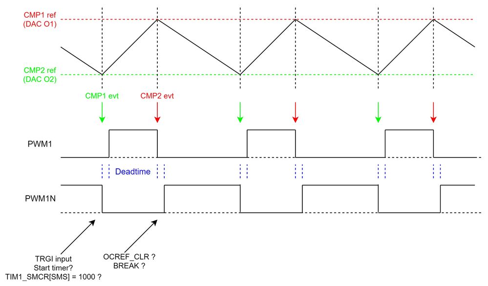

I am struggling to find how (or if) is possible to use the TIM1 (advanced control timer) of the STM32FG071 to run a hysteretic current regulator completely in hardware (without relying on software)
The idea is to use both comparators of the chip together with the 2 values of the DAC to set maximal e minimal current values, and then feed the current signal to the input of both comparators and let this information control the set /reset of the OC1 & OC1N outputs (to also take advantage of the deadtime), therefore controlling both frequency and duty cicle of the output stage.
As shown in this image:
The problem is that the due to the fairly complex control of this timer module and all its possible configurations I am not even able to conclude if it's feasible or not, I've already thought about using One Pulse Mode, OCREF_CLR, Gated mode and Break inputs, but the more I read the more complex it gets..
My question goes to the ones that are already experienced with the advanced parts of this timer, is this idea feasible? if yes, which features should I combine to put it to work?
OPM + OCREF_CLR ?
OPM + BRK ?
TRGI + OCREF_CLR ?
TRGI + BRK ?
what else could work ?
Thank you all in advance
Best Regards
Gustavo

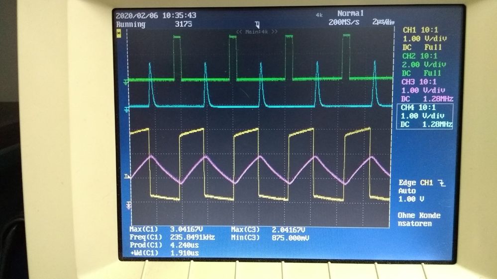

Here are the waveforms:
Green is COMP1 output
Blue is COMP2 output
Yellow is PWM H output (is driving a RC to generate the test signal)
Purple is the test signal being injected into both comparators inputs (PA1)
I set all polarities in the break configuration to active HIGH, and configured the COMP1 (green, ETR source for timer reset) as inverted (it goes HIGH when the signal is lower than the DAC setting)

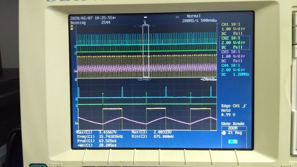

CSR volatile uint32_t 0x30851 (Hex)Waveform with CCR1 = 0x1400 (40us, register content above), it works:
Yellow is the PWM output
Purple is the signal being fed to both comparators

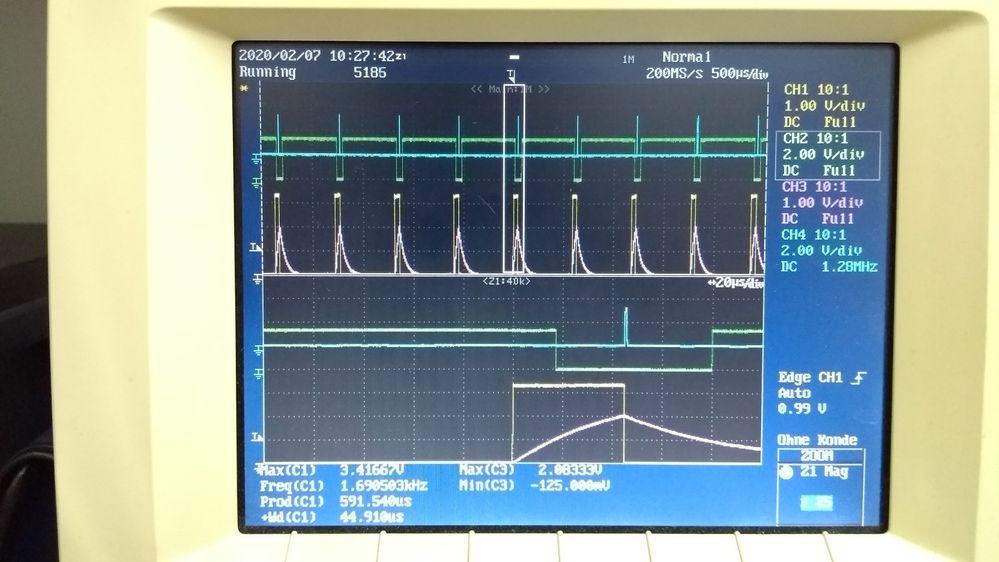

With the same configuration, but with CCR1 = 0x3200 (100us), it stop working the slave reset, and the maximum period (ARR = 0xFFFF, 512us) happens:
Do you have any idea why the Slave reset does not work only when OCREF_CLR is used and the CCR period is still "on" ?
Thanks again
Gustavo
