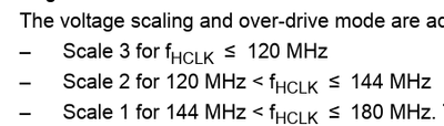

2024-01-22 4:26 AM - edited 2024-01-22 4:29 AM
First set scale to 1:
If not working with your HSE crystal, just set (ioc Mx edit) to HSI and try connect debug then.

As for the Scaling we used the values generated by the cubemx software.

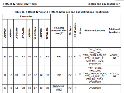

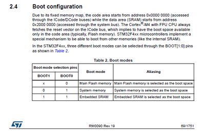

2024-01-22 8:05 AM - edited 2024-01-22 8:06 AM
Hello
Try to pulldown PB2 pin or connect it to Gnd, it seems to be BOOT1.
Datasheet:
Ref.manual:
Br JTP
