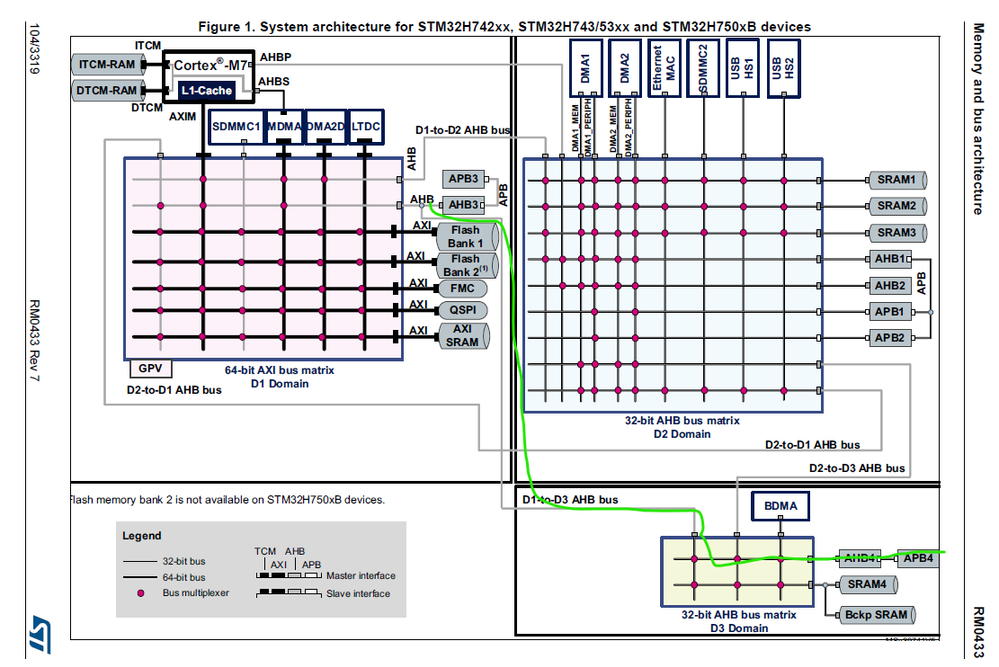

I need to service an external watchdog when a flash sector is being erased. The sector being erased is in the same flash bank where code is executed from. Before I try to jump and run from RAM I had a few questions.
Where is flash stall discussed in the reference manual?
Given the chip architecture, is there any issue with toggling a pin on Port G when a sector erase is ongoing? In other words, is the AXI bus matrix stalled during a flash erase?
No, flash erase alone is not causing bus matrix stall.

Thanks for the responses. What is curious is on a previous version of the software with the exact same hardware, the external watchdog strobes were occurring on the pin during a flash sector erase. We moved to new firmware including a new HAL and now there is a dead time of 848 ms.

No, but I wanted to check if anyone else ran into this problem where it used to work and now it doesn't. Also, I wanted to check if the AXI bus matrix is affected, because if it is then running from RAM will not work.
