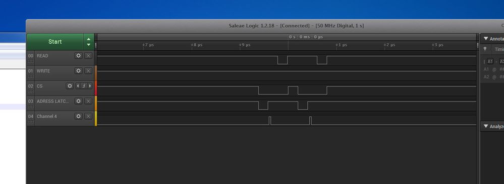

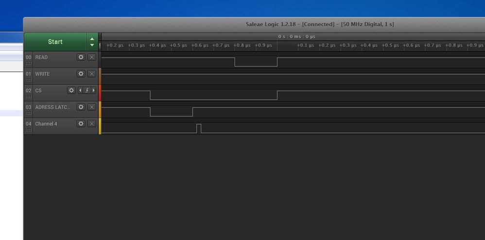

I have hooked up all the hardware wiring between the FPGA and ARM and guess what, as usual really really strange thing happening ?
why when I use
HAL_SRAM_Read_16b(&hsram1, (uint32_t *)0x60000001, (uint16_t *)rxBuffer, 1);
I get two chip selects and two reads
Yet when I read 60000000 I only get one CS and one read, WHAT IS GOING ON ???
HAL_SRAM_Read_16b(&hsram1, (uint32_t *)0x60000000, (uint16_t *)rxBuffer, 1);
Both these above HAL_SRAM_Read commands should simply read back ONE 16bit (2byte) data from the selected address
but anything above 0x60000000 does 2 chip selects and two reads of the data
is this a floored faulty FMC module
0x60000000 should = 1st 16bit address read
and
0x60000001 should - 2nd 16 bit address read (why 2 chip selects and 2 reads of data ??)
