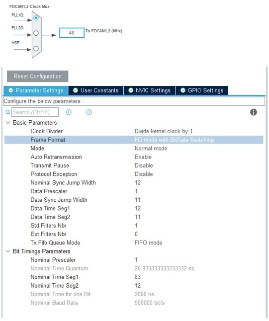

Dear,
FDCAN does not work.
Please advise if there is any problem in the entire code below.
The set clock of FDCAN is 48Mhz and each setting is as follows.
When the code is executed, Tx is transmitted once every 4 seconds in the while loop.
However, if Tx is entered about 4 times, it always falls into Error_Handler.
Error returns Error at the bottom of HAL_FDCAN_AddMessageToTxFifoQ function.

Another important clue is that if you change just one line of frameformat to FDCAN_FRAME_CLASSIC in the entire code, it will operate normally with CAN2.0 (not FDCAN).
hfdcan1.Init.FrameFormat = FDCAN_FRAME_FD_BRS; -----------> hfdcan1.Init.FrameFormat = FDCAN_FRAME_CLASSIC;

static void MX_FDCAN1_Init(void)
hfdcan1.Instance = FDCAN1;
hfdcan1.Init.ClockDivider = FDCAN_CLOCK_DIV1;
hfdcan1.Init.Mode = FDCAN_MODE_NORMAL;
hfdcan1.Init.AutoRetransmission = ENABLE;
hfdcan1.Init.TransmitPause = DISABLE;
hfdcan1.Init.ProtocolException = DISABLE;
hfdcan1.Init.NominalPrescaler = 1;
hfdcan1.Init.NominalSyncJumpWidth = 12;
hfdcan1.Init.NominalTimeSeg1 = 83;
hfdcan1.Init.NominalTimeSeg2 = 12;
hfdcan1.Init.DataPrescaler = 1;
hfdcan1.Init.DataSyncJumpWidth = 11;
hfdcan1.Init.DataTimeSeg1 = 12;
hfdcan1.Init.DataTimeSeg2 = 11;
hfdcan1.Init.StdFiltersNbr = 1;
hfdcan1.Init.ExtFiltersNbr = 0;
hfdcan1.Init.TxFifoQueueMode = FDCAN_TX_FIFO_OPERATION;
if (HAL_FDCAN_Init(&hfdcan1) != HAL_OK)
Error_Handler();

Not sure if I remember the following correctly from H7 FDCAN:
I think the TX FIFO can hold 4 messages.
The TX FIFO auto-clears with certain settings only if it receives an ACK from any receiver.
So, you sure that the receiver supports bit rate switching at 2 MHz?
If not -> no ACK -> TX FIFO full after 4 messages

Thank you for your reply.
There was no problem with the code I posted.
However, the message about TX FIFO full was ignored.
And the problem of not reading the message properly was that the CAN analyzer I used had a problem reading CANFD.
2023-04-14 3:31 AM
