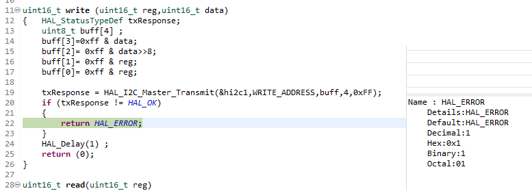

Hello @KHALSI_Foued,

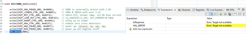

I have now another error, it hasn't happened before :

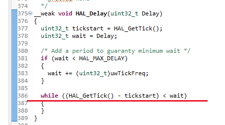

what does it mean that the target is not available ? I'm stuck at this line
Something was wrong with my SysTick ? How to check my SysTick if it's working properly ?

Sorry now I can locate the error :
HAL_I2C return 1 as error What does that mean ?

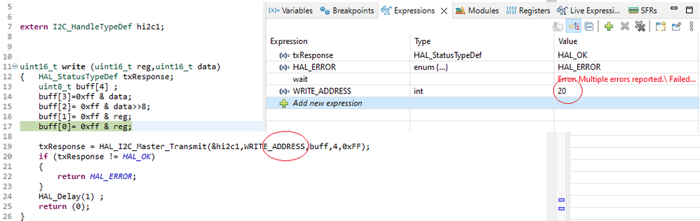

I think I gave a wrong address for the CODEC.
Normally after the DS
After me the Adress is 10 (dec).
2023-03-01 1:45 AM
Please check results via an oscilloscope. (Maybe it can be not the correct Address)

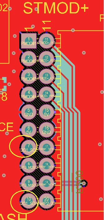

I've a evaluation board STM32L552E-EV and after the PCB :
I check the pin 7 and I have nothing SCL and nothing either and nothing either for the SDA pin. How it's possible ?
